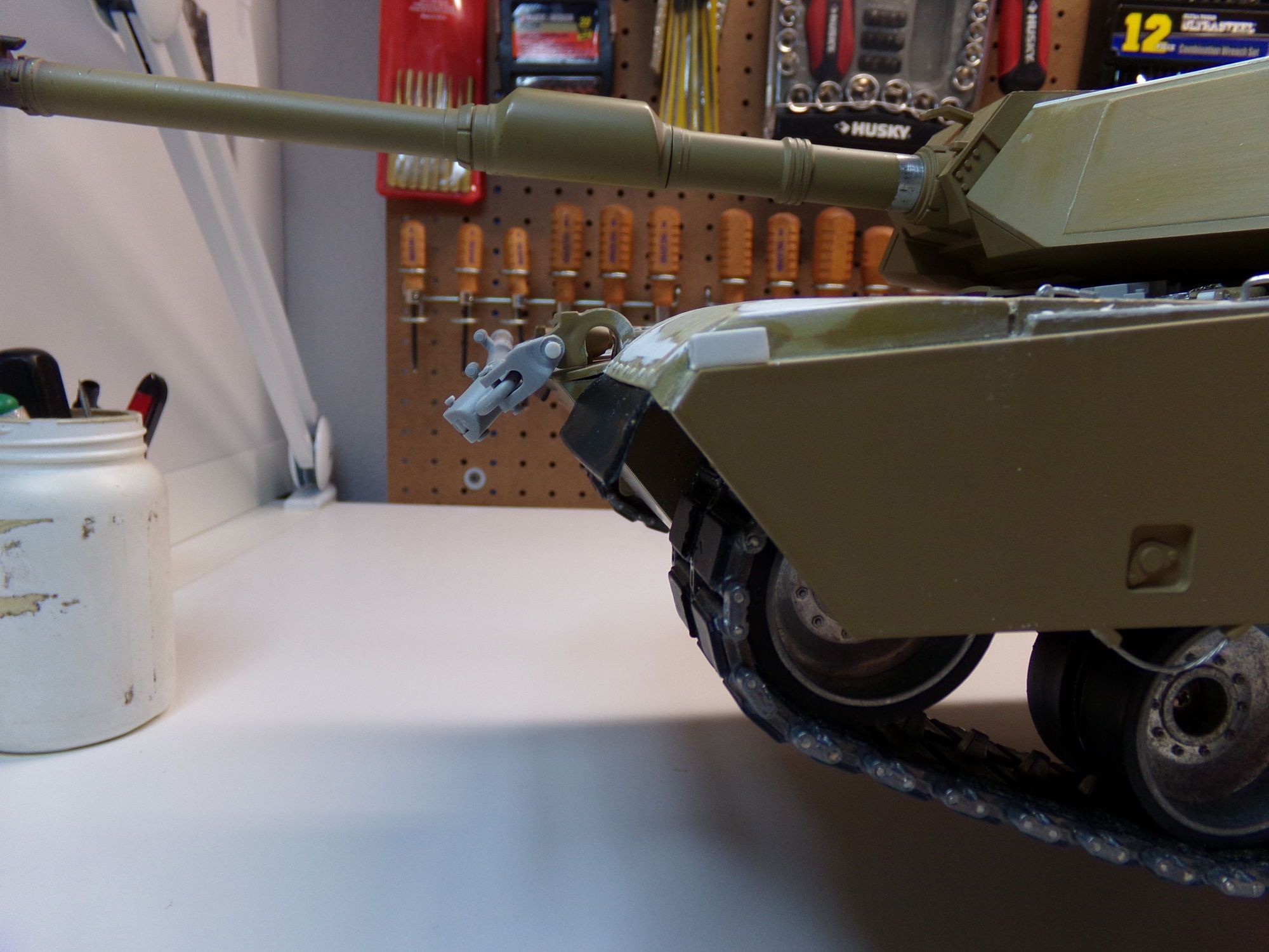

Shot of the vinyl mudflaps that are flexible. Made from some waterproof tape from T-Rex. Basically the tape was folded over on itself as the part you see and then the sticky part of the tape mounts it to the inside of the track well. Footman loop replaced with steel cable and the solid box replaced by a scale hollow one. Bolt detail added to track skirts.
